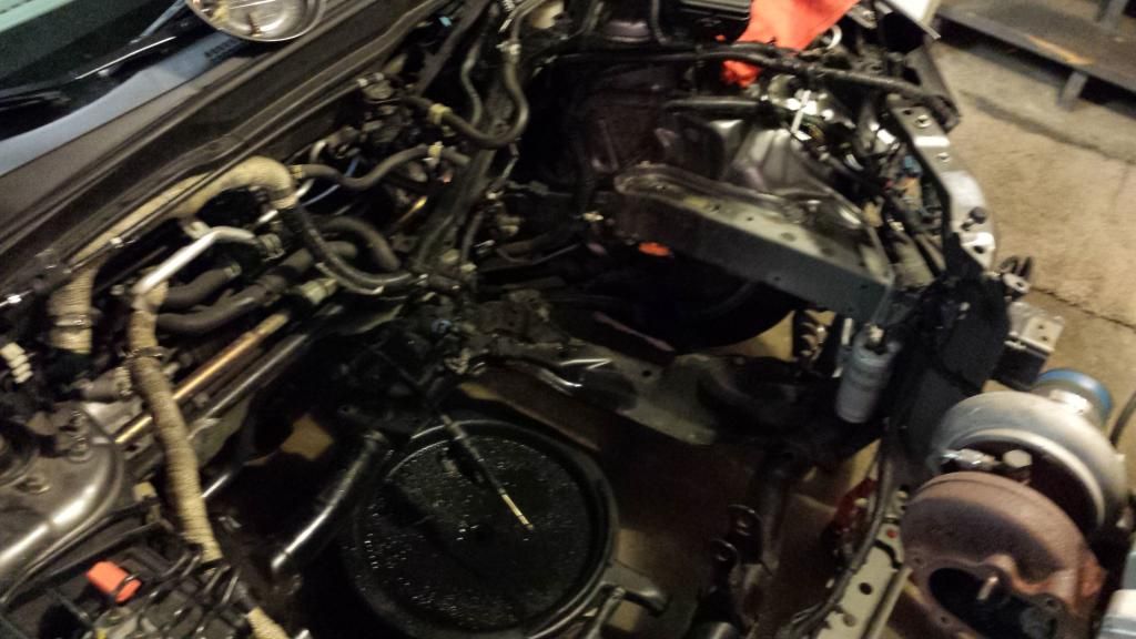

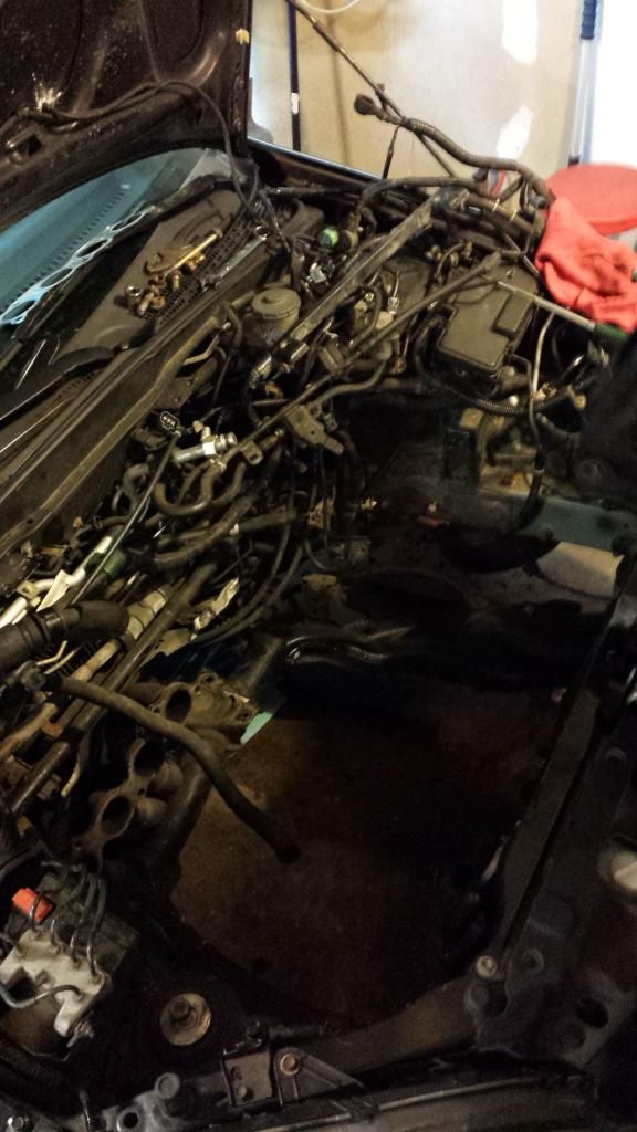

So we got the car in the garage and up in the air. As you can see here, the car had a K24a2!
We got on the first day pretty far on the removal of the engine.

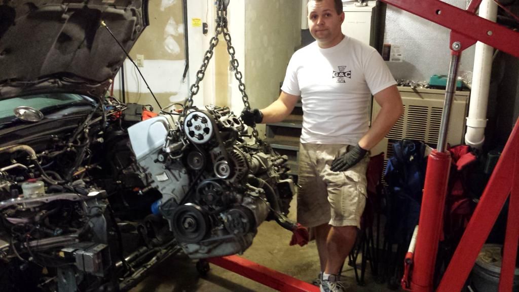

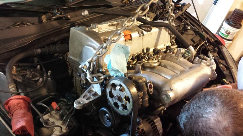

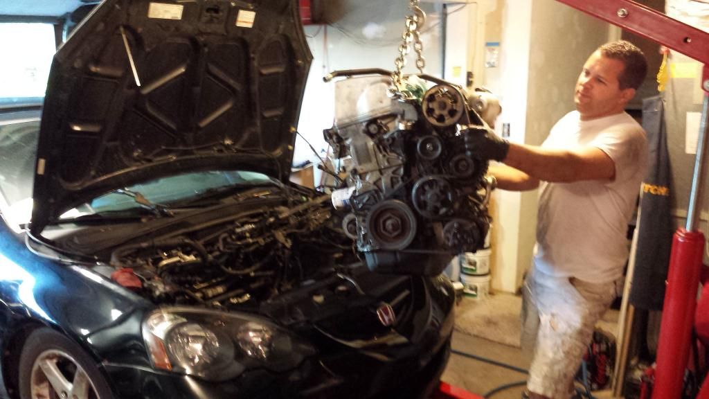

Got the motor on the picker
After some careful manipulation of the engine within the engine compartment, we got it out of there.

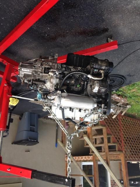

Here it is out of the car.

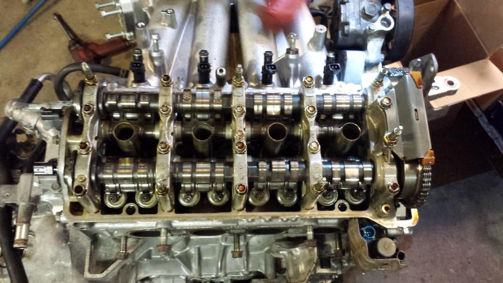

And also I decided to get the valve cover taken off for paint.

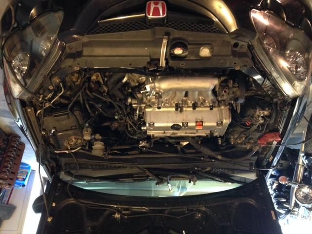

After removing the k24 we decided taking the entire front end, including the core support, radiator, etc out would be the best method to remove and replace on my car.

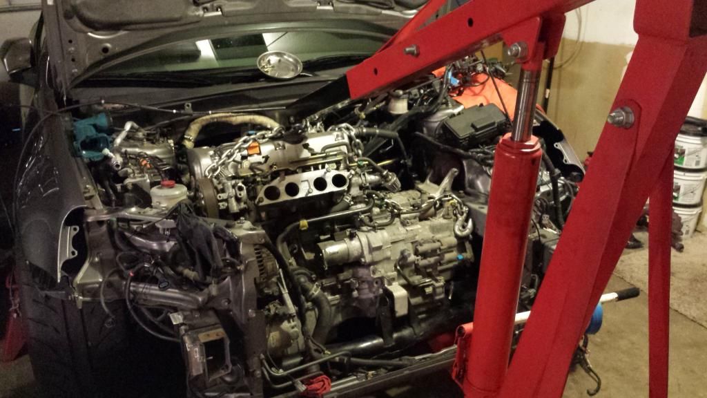

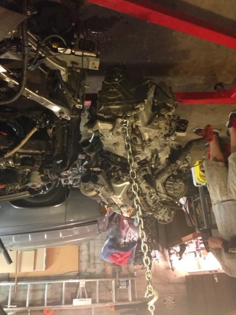

Unhooked everything we could and got the base engine on the picker this time.
Its removed! You can see how low we had it to remove entirely, core support out of the way makes things a TON easier.

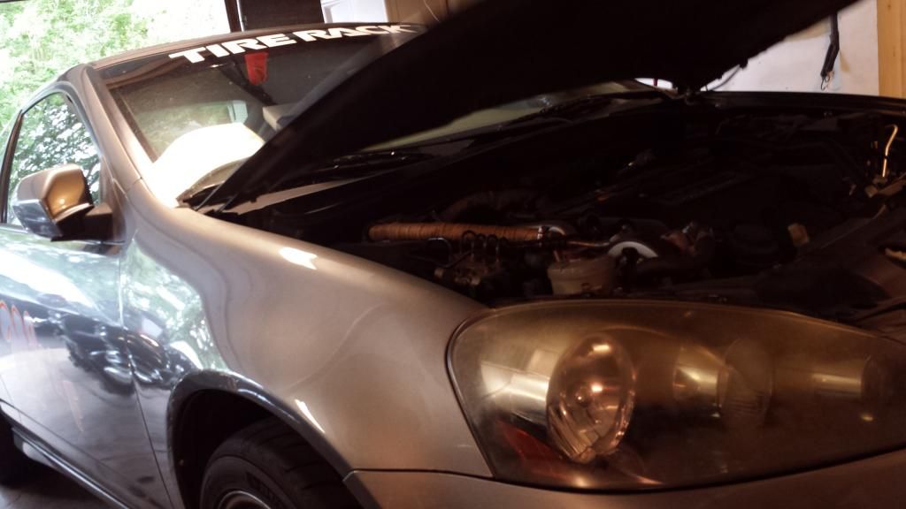

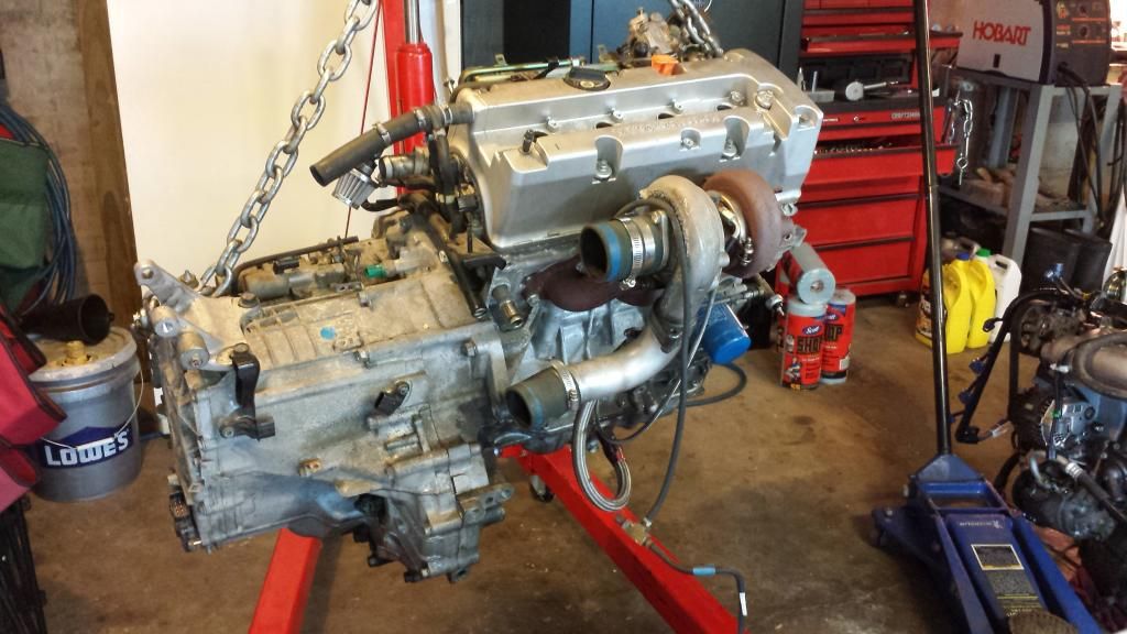

Here is the k20a3 with the turbo manifold all attached still.
It was a good run for the car as it was. But it came to an end, even though it still ran just fine!

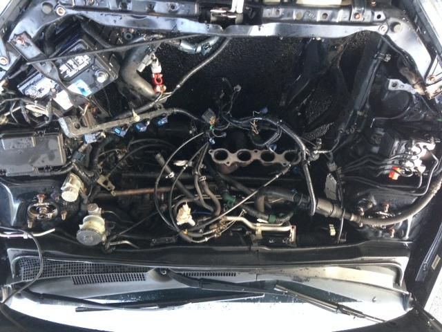

So much room! If you notice the ac hardline removed, its because we ripped it out due to the turbo rubbing a hole through the hard line.
